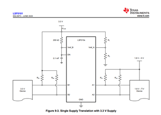

LSF0101: Incorrect capacitor reference in datasheet
Part Number: LSF0101
Hello dear support,
I am reading through the datasheet for LSF0101 and on page 14, Figure 9.3, In my opinion the shown capacitor of 0.1mF is incorrect and it should be 0.1uF/100nF.
Can you please advise if this typo is a typo or the capacitor really needs to be 100uF?
Thank you in advance.
Miroslav Ivanov
CID, Electroncis Design Engineer
