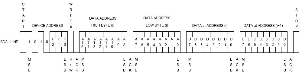

  • In case of the TUSB3410 device accesses a Cat 3 device like this: Two bytes of data are written to addresses i and i+1. Two bytes of data address, A15 to A0, are sent out before the data bytes (Take a look at the attached Write-I2C-Cat3.jpg).
    Note: There are certain restrictions to the types of EEPROM devices that can be used. I2C EEPROM devices available on the market can be grouped by the way they are addressed on the I2C bus. It is necessary to consider this when selecting a device for use with a TI USB controller, since some types are not supported with some controllers, and in some cases the device address may need to be configured differently depending on the type.
  • I appreciate the time you're spending to help me, and I think we're getting to the heart of it now. I have code that I'm confident will correctly write data to the EEPROM, and I am confident because the TI docs are clear, and also because I based my code on the TI bootcode example. The problem is that if I do writing in a loop, the first one will succeed and the next write will fail. I know the reason for this - to quote the EEPROM manual:
    During the internal Write cycle, the device disconnects itself from the bus, and writes a copy of the data from its internal latches to the memory cells. The maximum Write time (tw) is shown in Table 17 and Table 18 , but the typical time is shorter. To make use of this, a polling sequence can be used by the bus master. The sequence, as shown in Figure 10 , is:
    1. Initial condition: a Write cycle is in progress.
    2. Step 1: the bus master issues a Start condition followed by a device select code (the first byte of the new instruction).
    3. Step 2: if the device is busy with the internal Write cycle, no Ack will be returned and the bus master goes back to Step 1. If the device has terminated the internal Write cycle, it responds with an Ack, indicating that the device is ready to receive the second part of the instruction (the first byte of this instruction having been sent during Step 1).
    I have attached their figure 10 (with my annotations in red) which shows how they think it should be done. My question is, how do I do the part marked ???, detect when the EEPROM is busy? By the way the EEPROM is one that is supported by the TUSB (it is listed in the TUSB burner manual), so no worries there.
    Peter
  • How about this part of the M24C64 EEPROM’s datasheet?
    4.3 Acknowledge bit (ACK): The acknowledge bit is used to indicate a successful byte transfer. The bus transmitter, whether it be bus master or slave device, releases Serial Data (SDA) after sending eight bits of data. During the 9th clock pulse period, the receiver pulls Serial Data (SDA) Low to acknowledge the receipt of the eight data bits.
    If you can somehow write one byte data transfers, one after the other you could monitor each ACK. This is just to make some experimentation. Please let me know if it makes sense.
