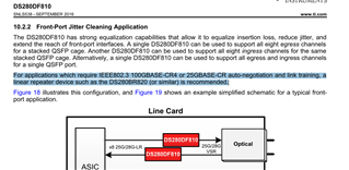

Also in data sheet , it shows
"For applications which require IEEE802.3 100GBASE-CR4 or 25GBASE-CR auto-negotiation and link training, a
linear repeater device such as the DS280BR820 (or similar) is recommended."
Could you let me know the detail or rule for that ?

    • Auto-negotiation takes place at 312.5 Mbps.  To support auto negotiation, you must enable RAW data output when CDR is not clocked.  You can enable this by setting channel register 0x1E[7:5]=0.  See programming guide for details on register.
    • The DS280DF810 does not support link training.

    if I change to DS280BR820 , can it support Auto-nego and Link-Training ?
    Could you let me know the difference between DS280BR820 and DS280BR810?
    thanks
    PEter
  • Hi Peter,
    I'm wondering if disabling AN is an option for this application.
    The DS280BR820 can support auto-negotiation and link-training since this is a linear redriver device.
    The DS280BR810 has AC coupling capacitors on RX and TX.  The DS280BR820 only has AC coupling capacitors on RX.  Due to removal of AC coupling capacitors on DS280BR820, it has improved high speed performance relative to DS280BR810.
