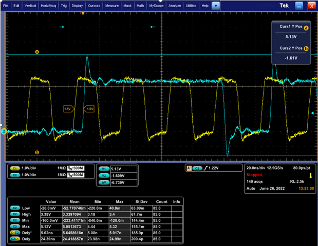

Hello E2E,
I have a question about the PCI-Signals behind the bridge. We have 2x Standard PCI Slots and see a big undershot on the PCIBus (-1,6V). Your XIO2001 datasheet "Absolutely Max Ratings Vil = -0,5V".
My question now,
What is your opinion?
