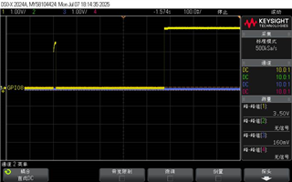

1. Harman found an abnormal case that GPIO8 of 948 will on for a short time after below code is implement done and we can’t avoid this spike plus now.

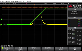

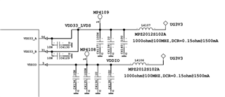

This is another abnormal case be found in 948.
When power on 948’s 3V3 power rail the GPIO2/3 will rise to 2.2V then drop to GND .
How to avoid such power up condition?
