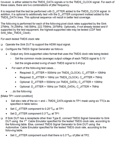

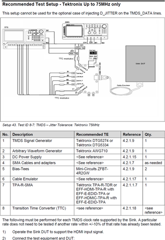

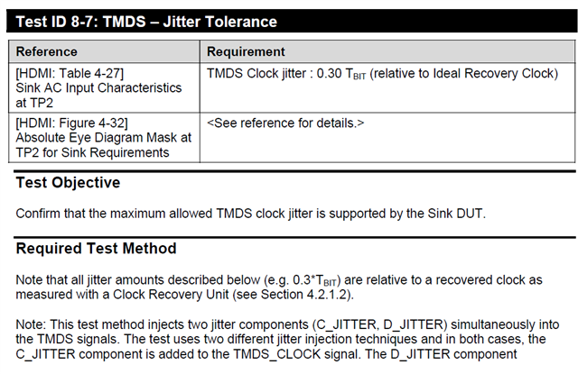

  No.2 INPUT Test ID 8-7: TMDS – Jitter Tolerance
            Only the 27M Type 2 27MHz (JAE) configuration FAILed, while the 27M Type 1 Cat1+Cat2 (Agilent) configuration and 74M, 148M, 222M, 297M PASSED.
            Initially, I thought that the FPGA lacked jitter tolerance, so I contacted AMD, but they assured me that the FPGA would not be able to receive the data without jitter cleaning with Redriver.
            I referred to the datasheet but could not find a good setting to increase jitter tolerance at low transmission rates. Please let me know what to try.

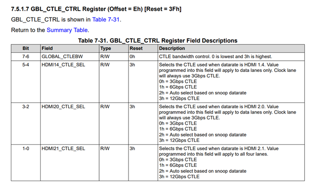

    The TMDS1204 data sheet contains the following description.
    The TMDS1204 supports adaptive equalization (AEQ) for HDMI 2.1 FRL.It does not support AEQ for HDMI 1.4 or 2.0.

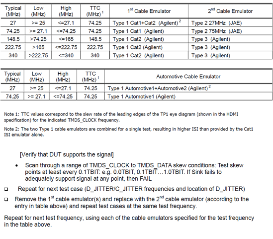

    What we want to improve is the RX jitter torelance at low bit rates in HDMI 1.4.
    You suggested tuning down the TMDS EQ settings, but please tell me the specific registers.

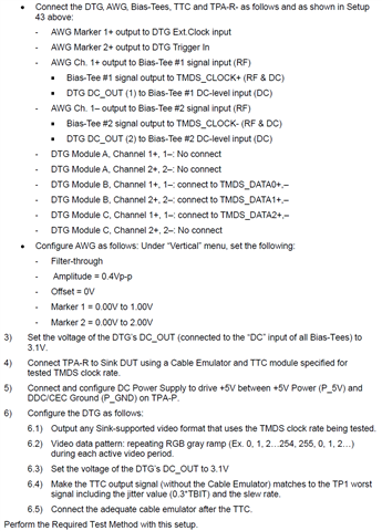

    For reference, please find attached the test procedure manual for Test ID 8-7: TMDS - Jitter Tolerance.
    I don't know how to attach files, so I'm posting a screenshot.

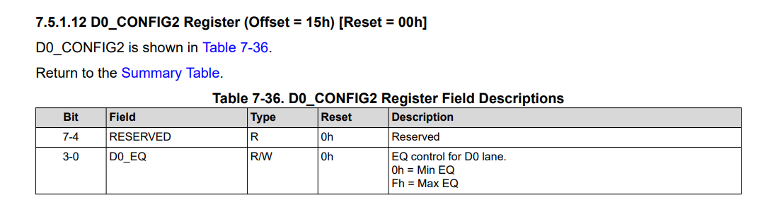

  • Higashimoto-san
    The TMDS1204 has three sets of CTLE curves (3Gbps CTLE, 6Gbps CTLE, and 12Gbps CTLE) with each curve having 16 AC gain settings and 3 DC gain settings.  The expectation is Map A and C should be used if TMDS1204 is used in a source application and Map B for a sink application.
    For the CTLE selection, this is register 0x0E as shown below.
    For each lane EQ, they are register 0x15h, 0x17h, 0x19h. Please note there is no EQ for the CLK lane when in the TMDS mode.
    David
