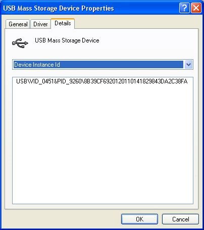

    Here's another way to look at it:  If I go into the Device manager in Windows and look at the properites of the drive under "USB devices", here's what I see for one of the boards:

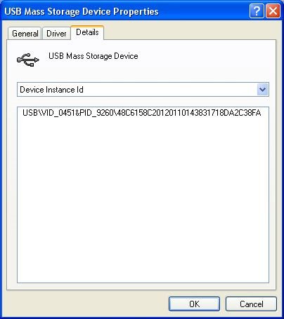

    Now If I look at the other board the same way:
    You can see that the two ID strings are different.  I believe this is the root of the problem, as windows builds these ID strings from descriptors it reads from the TUSB9260's registers.  We just need to have every programmed board return the same descriptor.
