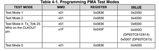

    This device has 4 different test modes as described in the Open Alliance Testing document (https://www.ti.com/lit/an/snla389e/snla389e.pdf):
    I have some questions:
    • What PMA test is the customer trying to run, what test mode are they trying to enable, and what is the register procedure they have followed?

    Customer needs to test Test mode1, 2, 4, 5. Communication is normal, and the registers are accessible.
    1. After setting the appropriate mode, what is the way to confirm that the PHY is actually working in the mode that is being set?
    2. What is the potential reason why there is no waveform output if it is confirmed that the PHY is operating in the set mode?
    Thank you!
    The only method I am aware of is to re-read the test mode register(s) to ensure that the write was successfully applied. Some customers in the past have written to the wrong registers when they were trying to enable the test mode. I have not heard of cases where the register was set but the PHY did not enter the appropriate test mode.

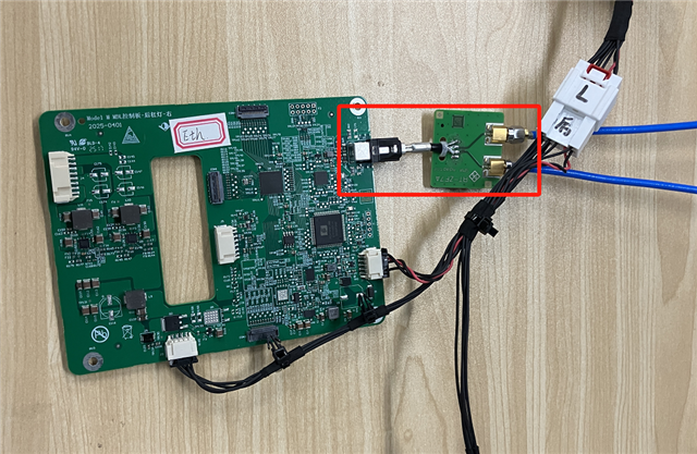

  • Hi Evan,
    "It turned out that they did not have a link partner" means to connect the host and slave and then measure the waveform on the bus?
    As shown in the figure, the customer is currently testing the Port directly after the Test mode is configured, and is this OK?

  • Hi Ivy,
    Not quite. For the specific test mode the other customer was asking for help with, it was necessary to connect the host and slave, then measure the output on a separate PHY pin that was not the Ethernet bus, but this is not necessarily the same for the other test modes.
    Thank you for the picture, but each test mode is different so we will still need more detailed information on the procedures. The picture setup would be able to check some test modes, but not all.
    For every test mode that the customer has found a problem with, please ask them to:
    • Clarify what exact register writes they are performing to switch the PHY into the specific test mode,
      • Verify with readback that the register writes were successful
    • Clarify what they have performed on hardware (where is the output being measured, was a link partner used, etc.)
