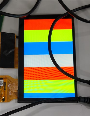

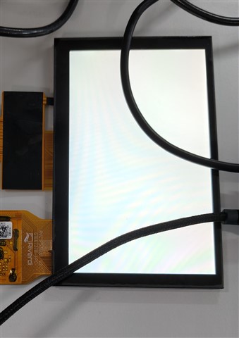

We are using SN65DSI83 dsi-lvds bridge for LVDS display panel, where test pattern works well and for actual android display we are just able to see white bright screen as shown in the pictures.
We see register settings all looks good. but we are not seeing proper display. could you please help us to identify issue here.
Test pattern,
Display during boot time, not for test pattern,

  • Hi Prathibha,
    We had a few initial questions about your device configuration:
    1. How are you generating the register writes sequence? Did you use the DSI Tuner tool for this?
    2. Have you verified the initialization sequence matches that in the datasheet?
    You will find in the datasheet section "7.4.2 Initialization Sequence" has particular requirements for EN pin settings, register writes, DSI clock and data lane settings, and resets. Please check that these are followed.
    3. It seems 0xE5 register shows 0x81 during initialization, indicating sync error and PLL error.
    Please clear this 0xE5 register during startup, by writing 0xFF. Then read this register again during runtime, and let us know what value is reported.
    Sync errors and PLL unlock errors may be due to the input (MIPI DSI) video timings not matching the DSI86 device timings. What are the timings set from the input?
    Also, is this white screen the expected video output? I suppose not, based on your description, but what is the video being transmitted?
