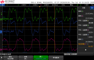

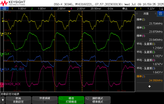

We had a project used the DS90LV011A+DS90LV012A for input a 24M HZ CLK.
DS90LV011A design as blew. But we found the screen will flick when device on.
Had try add 47pF to GND and series 56 ohm in TTL IN pin.
Issue had been improved but not completely resolved.
The TTLIN 、 OUT+/-、TTLOUT waveform as blew.
Seem TTLOUT have been attenuated.
Please help these question~

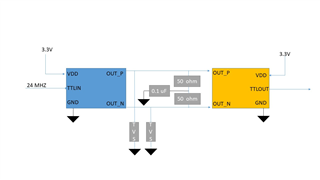

    1.) You have a 100 Ohm termination resistor (R1100) on the transmitter side of the LVDS bus. Point-to-point LVDS only requires one termination resistor at the receiver. If you have 2 termination resistors, that will definitely cause issues, but if the only termination resistor on the bus is on the transmitter side, i would still recommend moving it to the receiver. Do you mind sending the schematic of how the DS90LV012A is connected? It would also be very helpful to see the layout since LVDS can be sensitive to how the board is laid out. Can you send that as well?
    2.) You are shorting TTL IN to OUT+ via a 0 Ohm resistor (R1119). However, I see "NA" next to this resistor in green text. Does "NA" mean the same as DNP/DNI where the resistor is not present on the board? Also, can you explain way you added a 56 Ohm resistor and a 47 pF capacitor to these lines? You shouldn't need to attenuate the input clock signal.

  • Dear Matt,
    Thanks for feedback! Update this problem as below
    Please see ref schematic as attach. (Some part is design by customer so I can't just share the whole schematic.)
    NA mean didn't mount this material only for debug using~
    And sorry for the measure waveform update, previous picture may connect to the wrong GND for TTLOUT.
    The TTLOUT attenuate seem not to be so serious.
    But we still found that TTLIN and TTLOUT had 164.9 degree phase difference.
    I think it's not normal phenomenon. How can I fix this problem?

  • Hi Andy,
    Understood. Assuming the reference schematic you shared is exactly how the design is being implemented, the schematic part of this design should not be causing any issues. Like I mentioned earlier, layout can have a significant effect on the signal integrity as well. If you can't share the layout files, I understand, but please review this app note and make sure you aren't violating any key layout guidelines: High-Speed Layout Guidelines for Reducing EMI for LVDS SerDes Designs

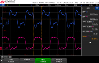

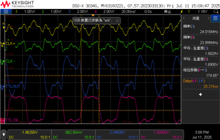

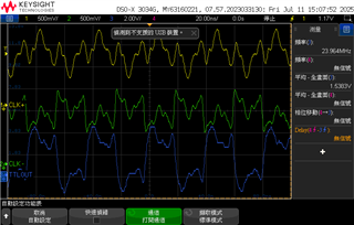

  • Dear Matt,
    We had try many peace of PCB and had the same result. It's seem not to be the single case of IC itself.
    And update waveform as below.
    Pink Color:TTLIN  (measure close DS90LV011A IC)
    Blue Color:TTLOUT (measure close DS90LV012A IC)
    Yellow Color:CLK+ (measure close DS90LV012A IC)
    Green Color:CLK- (measure close DS90LV012A IC)
    Observed the TTLIN and TTLOUT had a huge degree phase difference.

    If swapping the DS90LV011A/12A out with fresh units does not fix your problem, then your problem lies with how are connecting/laying out your board. Unfortunately, if you cannot share your schematic/layout files, I will not be able to help you anymore since we have confirmed the issue does not lie with our devices.
    Before I close this out, I will say this is likely due to the LVDS bus impedance not being matched properly. For example, in the original schematic image you shared, you have a trace through R1119 connecting OUT+ to TTLIN. While R1119 is not populated, this trace will still distort the impedance of the bus. I would recommend going through your schematic/layout again and try to remove all unnecessary forms of parasitic capacitance/resistance.
