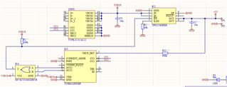

I want to confirm, if I understand the behavior of TUSB321 in Sink (UFP) configuration correctly.
My sink device 5V/3A need to check, if sufficiently powerful SOURCE (5V/3A) is connected and then I will enable the VBUS load switch. So, in development beginning, I choose the TUSB321 for this SNK application. Let me know if this is good choice.
According to the TUSB321 datasheet, SNK config must be:
1. CURRENT_MODE - left it floated or? Because this pin is use only for DFP or DRP mode. I didn't find any information in datasheet how to connect this pin, when PORT = LOW (UFP).
2. PORT - connected to GND (Because I want only UFP mode)
3. VBUS_DET - connected through resistor to the load switch output
4. ID - this pin is not active in sink(UFP), right? So, I need to control the load switch different way. I want to use OUT1/OU2 pins
5.  OUT1/OU2 - these pins report the source current capability, right? If the high current source (3A) will be connected, then both OUTx pins will be LOW (Table 2). So, I want to connect both OUTx pins to OR gate inputs and when both OR inputs will be LOW, then OR output will be LOW and turn ON the VBUS load switch.
Please, check if my circuit is correct.
Martin
  • Hi Martin,
    You can leave the pin floating, there should be no issues there.
    What is enabling the load switch? It looks like the EN pin of the switch is connected to the OUT pins of the TUSB321. If the TUSB321 does not see VBUS on the VBUS_DET pin, then it will not be able to detect whether a DFP is connected or not. It's better to route VBUS to VBUS_DET so that it will see VBUS once anything is connected. If the TUSB321 does not see a connection, both the OUT pins will be high, per table 2:
    Yes, ID can be floating.
    VBUS is required for the TUSB321 to see a USB-C connection. If VBUS is not enabled for VBUS_DET, then it will not be able to detect a connection. Additionally, OUT1/OUT2 are meant to communicate to your device typically the amount of power that can be drawn, based on what the host is advertising.
    Just to confirm, is the DIR pin being used to control a mux based on the FLIP orientation of the type-C cable?
    Is your intention with the load switch to not allow VBUS to be connected unless connected to a 5V/3A DFP?
    Ryan
  • Hi Ryan,
    I want to enable the load switch when only 5V/3A source will be connected. So, I got idea to use OUT1/OUT2 pins. Because, TUSB321 don't provide any other solution how to control load switch in UFP mode.
    Fine, I understand and I will connect VBUT_DET on the load switch input side (5VBUS).
    Yes, this correct. Then the OR gate output will be high and load switch will be OFF.
    Yes, this was my idea. When OUT1/OUT2 report that 3A source is connected, then I will turn ON the load switch according to OUT1/OUT2 signal and OR gate.
    No, my device don't have data capability. So, I don't need the DIR pin.
    Yes, you are right. I want to accept only 5V/3A DFP. Because, the device power consumption is 2A.
    Thank you for your help. If you have any other comments, let me know.
    Martin
  • Hi Martin,
    Are these reporting to the device that 3A is possible? If not, is the device only possible of pulling 2A? It cannot pull a lower amount of power?
    That should help with detecting VBUS, yes.
    I will say that this isn't an application we typically see with this device, however, as long as there is proper communication over the CC lines and VBUS is properly routed, I don't see why it wouldn't work. I don't have any other comments.
    Ryan

  • Hi Martin,
    Okay, got it, I think there was a misunderstanding on my part in terms of the spec and your application.
    After double checking, yes, you can pull any amount of current/voltage according to what your system needs, as long as it is within the 5V/3A limit set by the Source. I has a misunderstanding regarding whether you could variably change how much current was being pulled or not.
    The device downstream does not actually communicate how much current is being pulled, it just sees the amount allowed and begins to pull it. As such, as long as the amount being pulled is within the 5V/3A range, then I don't see any issues with this system. Sorry for the confusion on my part.
    Ryan
