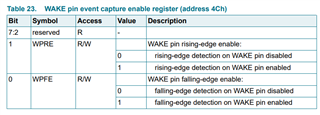

In TJA1145,  WAKE pin event capture enable register can enable or disable rising/falling edge detection independently. Does TCAN1145-Q1 support disable it as well? I can only see WAKE_PIN_CONFIG register, but don't have disable option.

    This is already configurable with WAKE_PIN_CONFIG, TCAN1145 doesn't use disable/enable, it needs to select the preferred way of detection, for example if you want to enable rising edge but disable falling edge detection, just set WAKE_CONFIG to 01b.
