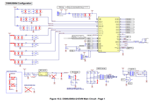

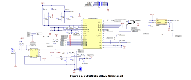

    3. Schematics
          Serializer:
          Deserializer:

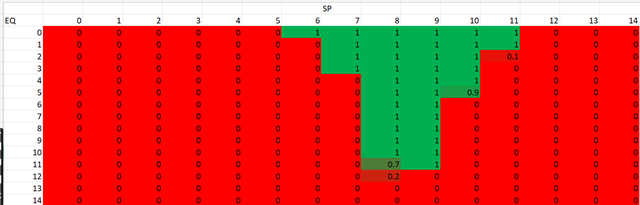

    We are also attaching the AEQ margin test results for the 1.524-meter cable we are using, obtained using the ALP tool.
    Why do you suspect this is a bandwidth issue? The cable's movement does not impact the data payload. The payload is sent by the camera and would not be impacted by cable movement. If only moving the cable causes issues, this indicates that the issue is likely the cable or the cable connections. A video glitch should result in a detectable error, are you sure no errors are being detected?
