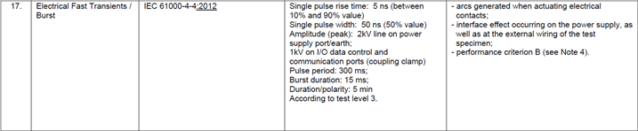

We are facing the following issues for EFT/B test.
-EFT/B test
-Issues
1. The connection between the PC and the TUSB2046B is lost, and it does not recover automatically. (Low frequency)
2. The downstream device of the TUSB2046B is lost, and it does not recover automatically. (Low frequency)
     Also, we tried to reset TUSB2046B from this state, but the issue did not resolve.
There are no issues connecting the PC to downstream devices without TUSB2046B.
We would like to know if you have any knowledge of similar issues.

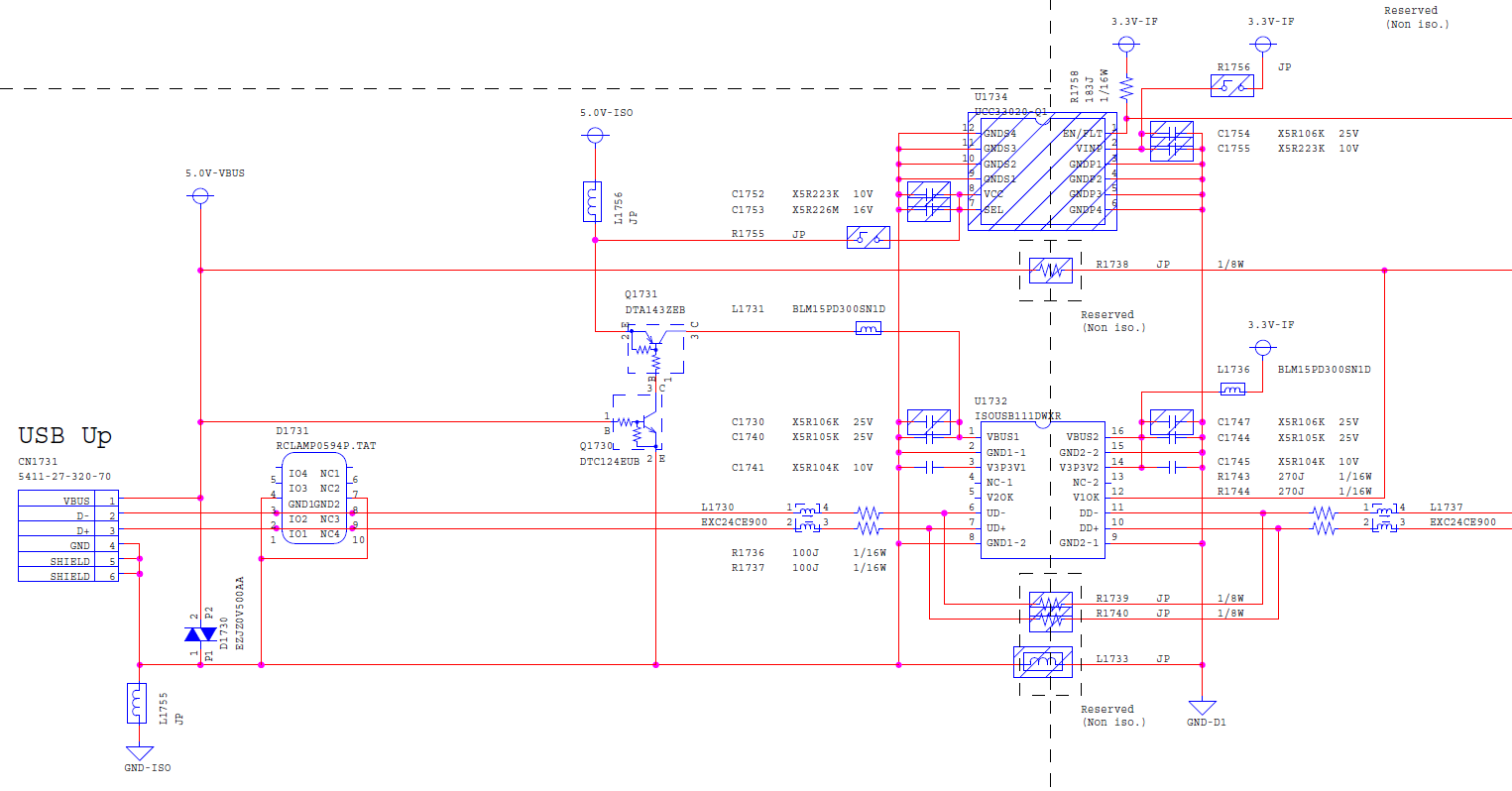

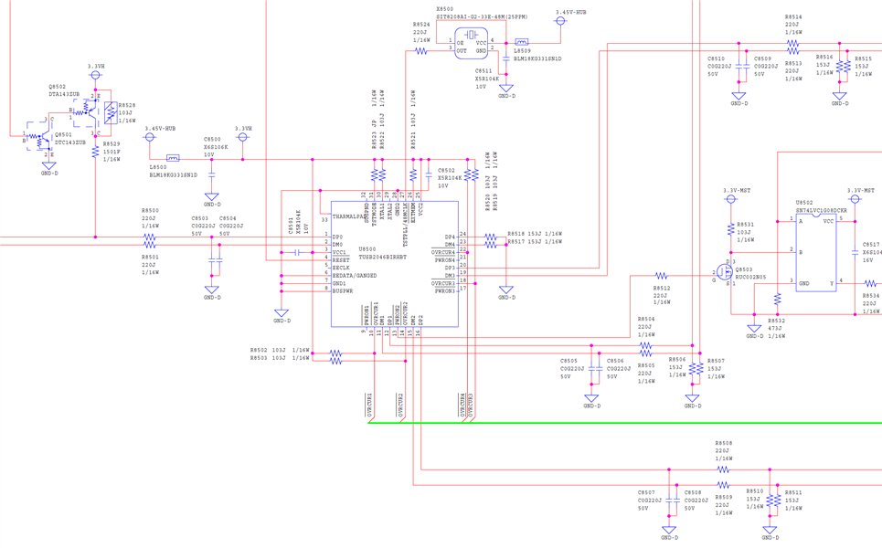

Attached is our schematic around the TUSB2046B.
