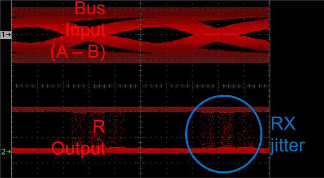

    Jitter is the deviation from ideal periodicity  (usually it is defined as the deviation from true periodicity). Which in a very simplistic example imagine you have a 1kHz square wave with 50% duty cycle - ideally the low and high time would both be 500us - but jitter would impact the pulse width where lets say you have +/-5us of jitter in the system you could see a high time of 495us and low time of 505us (as an example).
    Here is an example in an RS-485 system (not directly power bus - but explains the behavior pretty clearly with some images):
    First - an image with low output signal jitter - the "R" signal is a bit hard to see so I added rough red outlines to show where the "R" signal transition is occurring.
    Second image - high jitter
    These images are long exposure shots of multiple transitions - as you can see in image two the variation of the output RX signal is extremely variable which is going to be bad not only for EMI considerations but also can corrupt data or make accurate data collection very hard.
    One thing to note is that jitter is going to exist when using this part - there is a +/-2% duty cycle distortion inherent to the part - meaning the modulator has up to a +/-2% jitter inherently. The longer the bus is relative to modulation frequency will also add more jitter to the system. Usually in most RS-485 based systems 5% of jitter is more or less okay (it really will depend on end application) but they can go up to 20% (I generally wouldn't try to go that high - I try to keep it below 10% closer to 5% if possible in a system).

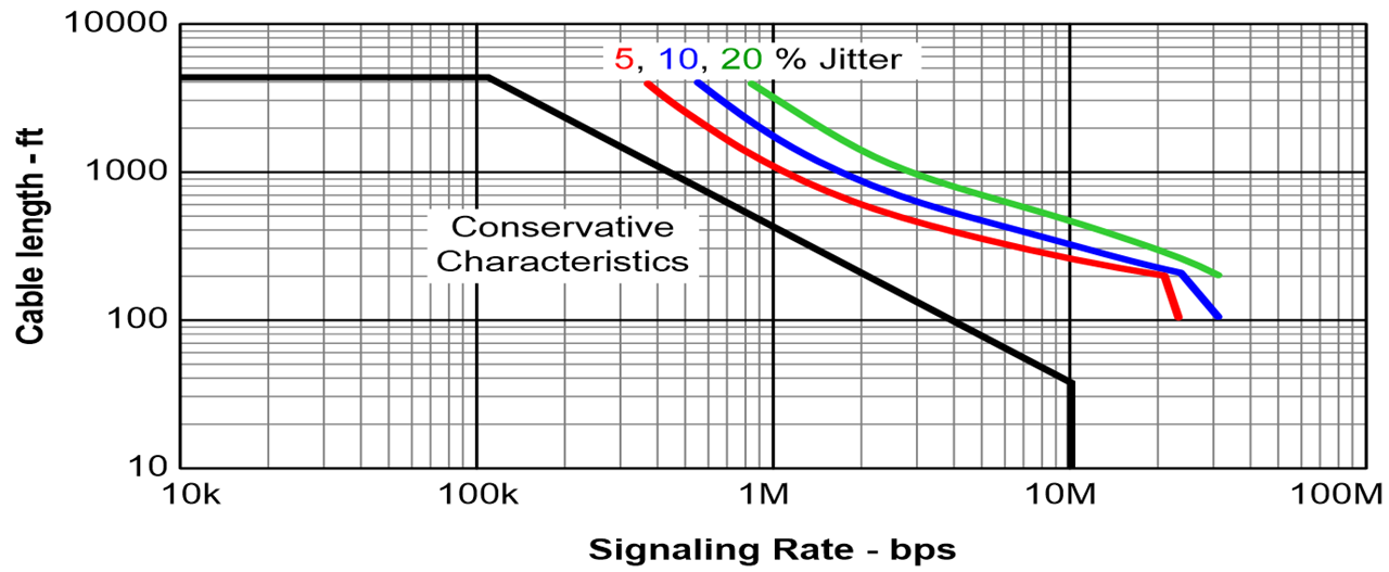

    We don't have a direct "guide" on length versus distance and jitter on this device (there is a generic RS-485/RS-422 one attached below)
    A couple notes about this graph however:
    1. The x-axis should be divided by 2 and changed to modulation frequency (i.e. instead of 10Mbps on the x-axis it would be 5MHz modulation frequency - and nothing before the 250kbps (which would be 125KHz) is captured.
    2. This assumes you are using 120 ohm twisted pair cabling - which in many Powerbus (THVD80x0) that is not the case - a lot of the time the wiring is not even impedance controlled.

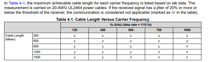

    We do have a general max length chart that assumes "20%" jitter max for the THVD8000 using more standard power cable:
    If you are under 300m for any of them you probably wouldn't be seeing a ton of jitter - but there is some value in this chart - at least when trying to determine boundary points.
