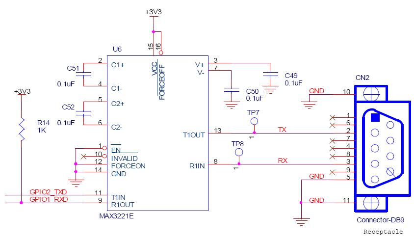

  • Hi Diego,
    You are correct on the pin assignment (IR_SIN=SIN), but keep in mind that when using our default serial FW then you should name it SIN. In you schematic, do you have SIN connected through a 5K resistor to 3.3V? Also, SOUT should remain not connected.
    I also noticed that all serial activity is being done through P3_0 (RXD) and P3_1 (TXD), they are connected to a MAX3221E. Do you have any kind of interface like this one? Please see attached image to this post (MAX-3221E.JPG).
