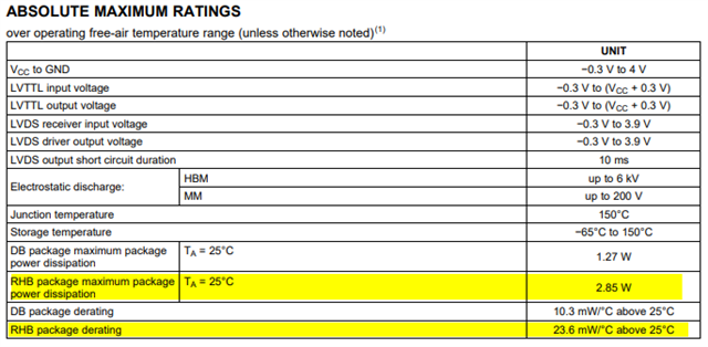

  • Hi Adi,
    Just wanted to touch base with you. I know I said that this would take about 2 weeks to gather, but unfortunately, there will be a delay on getting these numbers to you. Rest assured, we are fully committed to providing the data you need for your design in the coming weeks.
    In the meantime, I was able to find some thermal information in the device datasheet's abs max table (see below). This most likely doesn't provide the level of detail you are currently looking for, but I just wanted to highlight this to you while we continue to work on getting the rest of the data for you. Thank you for your patience.
