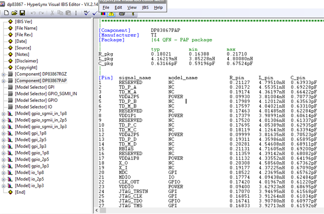

For SI simulation, we involve DP83867IR Transceiver but the pins TD_P/M_A/B/C/D are NC.
It is very difficult to model the MDI bus behavior using the IBIS model pullup and pulldown curve. So we only have the IBIS model on the MAC interface. We don't have any IBIS model on the MDI lines.
