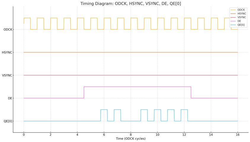

I have a question regarding dual-link DVI, which is not officially supported by TI.
However, since the integrated circuit we have been using for years is now obsolete, we are preparing a replacement solution — possibly using two TFP401 devices.
According to the DVI specification, HSYNC and VSYNC signals are carried only on TMDS channel 0. Therefore, we are concerned whether the second TFP401, which would be connected to TMDS channels 3, 4, and 5, and consequently would not receive any HSYNC or VSYNC signals, will still provide valid video output on its pixel interface.
We are aware of Application Note 5123, "Dual Link DVI Receiver Implementation", but it does not address this particular issue.
