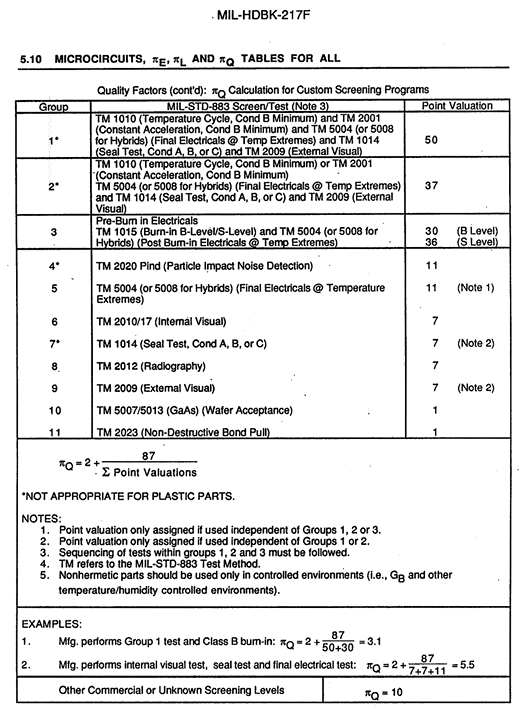

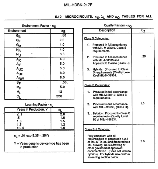

We are currently conducting a MIL-HDBK-217F based reliability analysis (Parts Stress Method) for a space-related defense application and are considering the use of the THVD9491-SEP device in our design.
The purpose of this request is to obtain TI’s recommendation for the appropriate πQ level of the THVD9491-SEP device based on its screening and qualification history, in accordance with MIL-HDBK-217F.
We would also appreciate receiving the supporting rationale or documentation that justifies this πQ classification.
To support this, we kindly request the following information for THVD9491-SEP:
1. Screening and qualification test summary (including Burn-in, LAT, Electrical Tests, etc.)
2. Any available documentation indicating screening levels equivalent to MIL-STD-883 (if applicable)
3. Radiation test results (TID, SEE, SEL) or corresponding RLAT summary
4. Certificate of conformance (CoC) or process flow, if available
