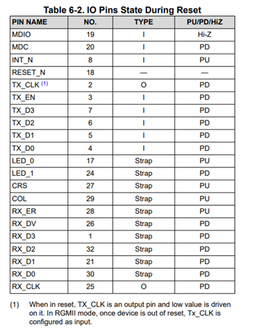

During RMII master mode will the DP83822 RX_CLK/ CLK_OUT signals float (Hi-Z) during device reset?
  • Hi Ronnie,
    From the datasheet, RX_CLK will be pulled low during reset.
    For clarity, the RX_CLK signal is not used in RMII mode:
    There is no CLK_OUT signal on DP83822. Is a CLK_OUT signal needed for your design?
    Shane

  • Hi Ronnie,
    DP83822 has similar functionality to DP83620, however these are two separate parts. I cannot guarantee they will treat the CLK pins the same during reset.
    For DP83620, RX_CLK will operate at 25MHz in reset:
    To confirm the behavior of TX_CLK and CLK_OUT it would be best to evaluate this on a DP83620 EVK. I can look into getting one of these, however it will likely take a couple of weeks to arrive. Is there a timeline when you need this data by?
