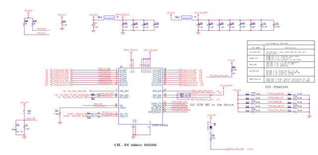

I am using SN65DP159RSBT in retimer mode for my HDMI 2.0 Tx application
Here, I am facing an EDID issue where the source is unable to read the EDID correctly and then proceeds to return an assumed value
This happens only when the monitor goes to sleep mode.
But when the monitor is not in standby/sleep mode for about 5-10 secs (where it displays no signal) and then we the source attempts to read an EDID, it will provide the details correctly
1. Is there something settings that should keep the monitor awake so as to read it whenever required
2. Should the retimer be responsible to keep the monitor awake?
3. Can it be possible that Monitor should send the EDID to source even when it is in Standby/sleep mode, but the retimer is not able to?
4. What is the purpose of DDC clock stretching here? Can i implement this? As i am confused due to the note on voltage levels that can be different on source and sink side (source is 3V3 and sink is 5V)
Based on the previous queries, we have one more setup (same setup and configuration) on which there is no toggling on the DDC lines at the sink side, we tried to give reflow multiple times but there is no improvement. Seems like the DDC Block is inactive.
For both the setup, OE pin is been provided with 2ms delay through an RC circuit since the 1V2 VDD will be arriving at 1.4ms while the 3V3 will be at instance 0ms.
Attached is the schematics, please let me know if any other details is required.

    What is being connected at the DP159 input? Is it a DP++ source and are you AC coupling the DP159 input?

  • Hi David,
    We are using a 9EG MPSoC SBC as a source, and yes, the source is AC coupled to the input of DP159

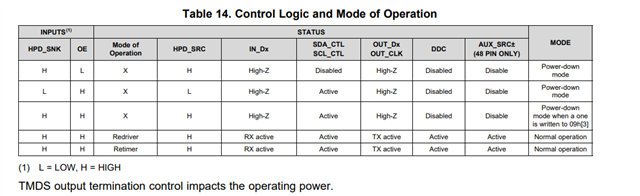

    The only time the DP159 DDC will disable its DDC is when it is in Power Down Mode. Below table shows the conditions the DP159 will be in the Power Down mode.
    But in normal operation, DDC should be enabled.

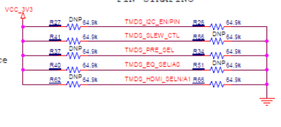

    Looking at the schematic, can you please provide the setting for these strap pins?

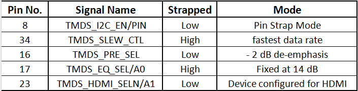

    The settings for strap pins are as is in the schematics, mentioned below for your reference

    This question is more for the monitor vendor. But does the monitor go into standby/sleep mode when there is no output out of the DP159?
    Looking at the strap configuration, I would leave the SLEW, Pre_SEL, and EQ_SEL all floating as the initial configuration.

  • M Karthik
    With EQ_SEL set to high and 14dB equalization, the signal may be get over-equalized and signal quality will be poor. I would expect with the change in the strap pin setting, you will see better signal quality.

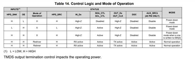

  • M Karthik
    The monitor/display EDID is not controlled by DP159. Please see below table for the DP159 control logic and mode of operation.
    When both OE and HPD_SNK are high in pin strap mode, then the DP159 DDC buffer is active and will pass the monitor/display EDID info to the source.
