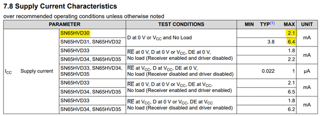

    All supply current info can be found in this table from the datasheet:
    Because SN65HVD30 is a full duplex device without enable pins, there is no standby mode where the driver and receiver can be turned off. Half duplex devices typically have separate driver and receiver enables where this standby mode is present.

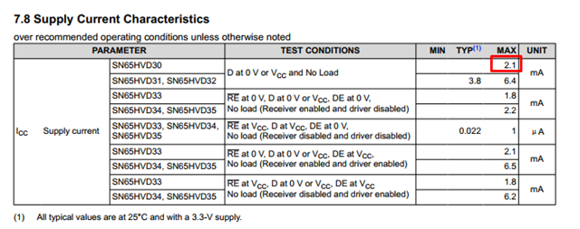

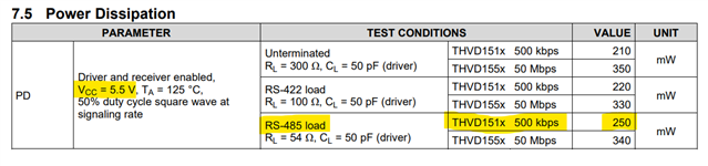

    I am currently estimating the system's current consumption, so I would like to obtain the maximum possible current consumption of the SN65HVD30 during normal operation.

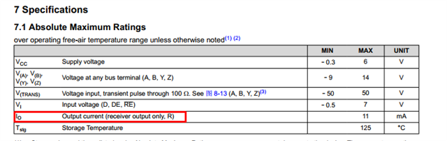

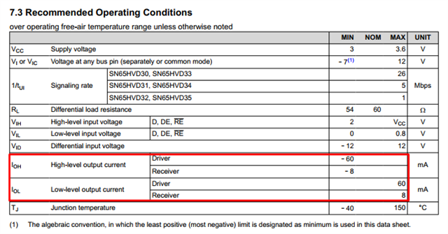

    The chip datasheet provides several current specifications, but I am unable to determine which one represents the maximum current consumption I require. As shown in the figure below, there are multiple current values listed. Could you kindly help me identify the correct one?Alternatively, could you kindly advise on the method to determine the relevant current specifications? Thank you very much.
  • Hi Sheng,
    The first two images are specifying the max current that will break the device (if you go at or beyond that maximum value). The image that I shared is the current draw with a constant D input signal, which can be helpful when comparing to other RS-485 transceivers.

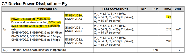

    The best approximation of the current draw (aside from ordering the device and testing directly in your system) would be to the use the Power Dissipation section:
    You can infer the current draw from this. This will give the worst case power draw when the driver input is a 50% duty cycle at high temperature.

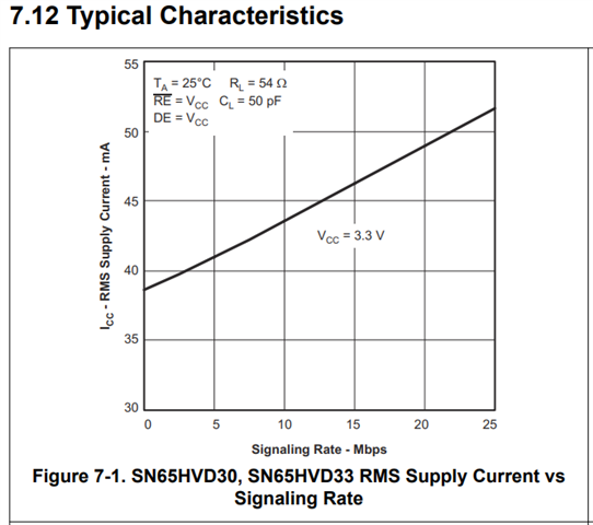

    Additionally, the graphs in the Typical Characteristics section are a more general guide for current consumption. Just note that we do not guarantee the performance of these graphs, but they are a helpful illustration of the device performance:

  • HI Sempsrott
    Thank you for your reply.
    The Typical Characteristics graph for the SN65HVD30DRG4 is quite helpful. Since the operating speed we are using is not very high (up to 115,200 b/s), I have selected a value of 38 mA.
