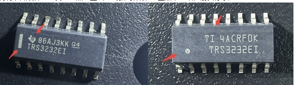

Part Number: TRS3232E
Hi
Could you please provide the PCN file of the physical marking of this product
thank you

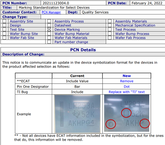

Hi Yingjiao,
PCN 20211123004 covers this marking change. Note that this PCN mentions MAX3232EIDR, but not TRS3232EIDR. These can be treated as the same device however.
The only changes on this PCN are regarding the device marking, no functional changes.
Let me know if that answers your question.
