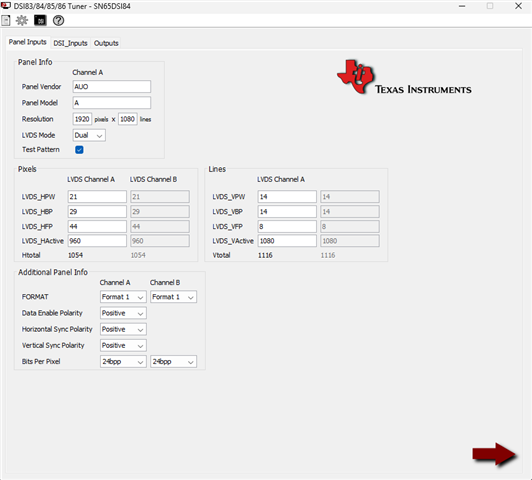

We are currently working on the bring-up of the TI SN65DSI84 DSI-to-LVDS bridge on our QCS615-based platform, running Linux kernel version 6.6.
As part of the validation, we enabled the test pattern generation feature in the SN65DSI84 driver. However, the test pattern displayed on the LVDS panel is unclear and distorted (see attached image for reference).
0181.G133HAN01V1 final spec ver 1.0_20190513.pdf.pdf

When the test pattern is disabled, the LVDS panel only shows the backlight, with no image or signal being displayed.

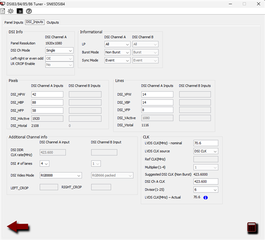

  • Hi Sudarshan,
    Thank you for the background info on the test pattern generation issue. I have a few questions about the setup
    • Is the SN65DSI84 using the DSI CLK or a REF CLK?
    • DSI setup
      • How many DSI lanes used?
      • What is the DSI lane speed/DSI clock frequency?
    If you could attach a I2C register dump of the SN65DSI84, that would be appreciated.
    Jack
  • Hi Jack,
    Thanks for the response. Please find my comments below.
      • Sudarshan - SN65DSI84 uses external reference clock of 100MHz (CLK_100MHZ_REFCLK)
    • DSI setup
      • Sudarshan - 4 lane DSI
      • Sudarshan - D-PHY v1.2: 2.1 Gbps/lane on four lanes per port, up to 8.4 Gbps/port
         DisplayPort v1.4 at 5.4 Gbps/lane, 21.6 Gbps/port with support for MST
        Up to a maximum of 5 MP;
    Sudarshan - Attached the I2C register dump for reference.

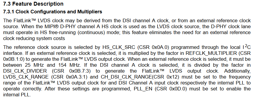

  • Hi Sudarshan,
    One quick correction on my previous response is that the LVDS clock for this display is nominally 70.57MHz because of dual LVDS ports. The AUO datasheet allows for LVDS clocks of 69.22MHz - 73.9MHz. The 100MHz REFCLK will not be an option for this display.
    The other option is to use the DSI channel A clock as the LVDS clock source. The DSI clock must be continuous for it to function as the LVDS clock source. The above datasheet section I sent previously details the steps needed to program the SN65DSI84 for DSI clock reference.
    Do you know the DSI clock frequency for this system?

  • Hi Sudarshan,
    For your configuration, we have the following
    • Nominal PCLK = 141.2MHz
    • LVDS CLK = 70.6MHz
    • DSI DDR CLK = 211.8MHz
    In order to enable the DSI channel A clock the following needs to be done
    • Set DSI_CLK_DIVIDER in Register 0xB[7:3]
      • Set this register to 0x10 to divide by 3
    • Set LVDS_CLK_RANGE and HS_CLK_SRC in Register 0xA
      • Set this register to 0x0b
    • Set CH_DSI_CLK_RANGE Register 0x12
      • Set this register to 0x2a
    • Set PLL_EN Register 0x0D[0] to enable the internal PLL
      • Set this register to 0x01
    I used the DSI tuner tool to calculate the appropriate register values. You can download the DSI tuner tool in the E2E FAQ below.

  • Hi Sudarshan,
    One correction: Set register 0xA to 0xB to enable the LVDS pixel clock to be sourced from the D-PHY clock.
    Jack
  • Hi Jack,
    Thanks for the response,
    Can you please provide the setting for the same? Like, Which bit need to set for both 0xA and 0xB register?
    Sudarshan
  • Hi Sudarshan,
    See below
        • Set Register 0xA[3:1] = 0x5
        • Set Register 0xA[0] = 0x1
    Jack

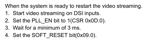

  • Hi Sudarshan,
    Thank you for your time on the call today. For tomorrow's call, there will be a live debug to root cause the PATGEN screen distortion.
    When I looked at the latest register dump I saw that Register 0xE5 = 0x1. This means that the SN65DSI84's PLL is unlocked. When I re-entered everything in to the DSI tuner tool, I realized that there are multiple misconfigurations due to LVDS CLK and Horizontal timing being divided by 2 when using dual LVDS mode.
    Instead of writing down the registers as above, I will send screenshots of the DSI tuner tool and the register output from the tool.

    The PLL_EN bit and SOFT_RESET bit are not set as they need to be set per the recommended sequence defined in the datasheet
    /resized-image/__size/640x480/__key/communityserver-discussions-components-files/138/first_5F00_page.png
    /resized-image/__size/640x480/__key/communityserver-discussions-components-files/138/second_5F00_page.png

    After a couple of meetings to debug the SN65DSI84-Q1, both PATGEN and end-to-end video was successfully brought up. All issues were caused by driver misconfiguration.
    1. PATGEN on SN65DSI84-Q1
    • The root cause of the PATGEN not working as expected was because the driver was incorrectly programming the horizontal video timings in the CSR registers.
    • When in dual LVDS mode, ALL horizontal timings including horizontal active must be divided by 2. This is the per port LVDS timing
    2. End-to-end video on SN65DSI84-Q1
    • From inspecting the driver and DSI CLK measurement, I had a suspicion that the line timing was not matched between DSI input and LVDS output
    • My suggestion to not use burst timing in the DSI mode flags fixed the issue with end-to-end video.
    Previous Driver Configuration
    Current Driver Configuration
