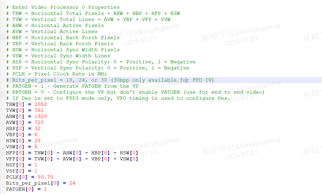

    The chart format is as follows:
    I have tried using Analog LaunchPad software to generate the patgen of the deserializer, but in reality, I only saw the pattern of the deserializer being generated. Can you help me generate a copy with the following timing? Thank you!

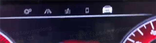

    I verified locally that our screen has automatic initialization. After disconnecting the screen power and then re powering it, the screen corresponding to port1 still has black stripes, and the screen corresponding to prot0 has not encountered any problems. The normal and abnormal images are as follows. In addition, when writing 0x01 to the 0x01 register of the adder, the black vertical bar on the screen corresponding to prot1 disappears. I think the problem lies with the adder
    normal
    abnormal

    -->Sorry, I didn't describe it clearly before. It's a black vertical bar
    I apologize for any inconvenience caused by the previous description. Let me rephrase it. The pattern of ti983 also has regular black vertical bars. By writing 0x1 to the 0x01 register of ti983, the black vertical bars in the pattern of 983 can disappear. Do you have any troubleshooting directions next
    Now it is a dual screen display method. Currently, the screen corresponding to Port0 has not encountered any problems, but the screen corresponding to Port1 may occasionally experience this issue
