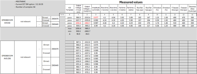

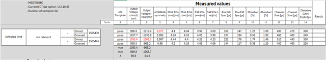

Hello, I have tow demo board with this PHY and I am facing that I measure at each piece different amplitude. the deviation is up to 90mV. Since the limit for ECT is in the range 100mV, this is much I would expect. Why there is such deviation. I did not found any information waht is distribution of the outptu amplitude. Can we get mote information about it?
    This deviation may be attributed to different corners of silicon, board design, setup variation (such as cabling/probing), as well as component tolerance. IEEE is a very strict standard in and of itself. While tolerances are always tricky to ensure performance is within specification from a HW specification, we also have register configuration which can help.

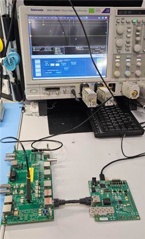

    I would like to ensure that setup/probing is as optimal as possible before diving into register configuration. Could you please provide the vendor you are using to measure, as well as photo of the setup?

    here is the figure of test setup. I am doing ECT test about 8 years with already many PHYs so I am convince that the deviation is cause by PHY is self. My the biggest concurs are the so big deviation in the amplitude depending at taken PHY piece and also the amplitude symmetry is on the edge. Can you provide me what is the tolerance of output amplitude or statistic deviations?  What can be adjust by reg?
    It appears you are using a TDSET3 FW which is similar to what is done in our labs. I just want to confirm that the picture you are using was done for 10Base-Te testing and not for the 100Base-Tx testing you are reporting correct?

  • I am confirming that I am measuring the 100BASE-TX Ethernet compliance. The setting in register is not suitable for us because it must be set differently for each piece of PHY. We are in the phase of developing of product with huge quantitie so this aproach is realy not possible.
    we need to know what we can then expect. Can you us the output amplitude specification , what level we can expect? Do you have also some distribution measurement over many sample, in the best case over the works case samples?

    I have personally seen run/run variation occur when utilizing TDSET3 software. Could you please try the following:
    - Increase sample size from 64 to 256
    - Run more than once (I've done 3x times) to get a general range of where the PHY is at performance-wise
    Tektronix had been consulted on this in the past and their response was that sometimes sampling isn't optimal and the tradeoff to increase size is time to complete a test. As the performances are very marginal, I would like to see if it was a bad acquisition being root cause of your dataset.

  • There are my result. Before I repeated measurement I make this
     - waiting 30 min before oscilloscope warm up
    - probe compensation was performed
    I wanted to point out that the simulate issue we discover with DP83822IF ( DP83822IF: MDI 100BASE-TX voltage tolerance  where the distribution was provided to my colleague. But in case of DP83869 I see even more output deviation
  • Hi Viktor,
    Thanks for providing the data points. It does appear that the violations are consistent. I am looking into why this is the case. Can you please provide the FAE that is assigned to your Siemens team? I would like to also coordinate efforts with them.
