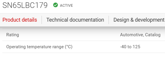

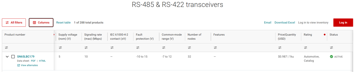

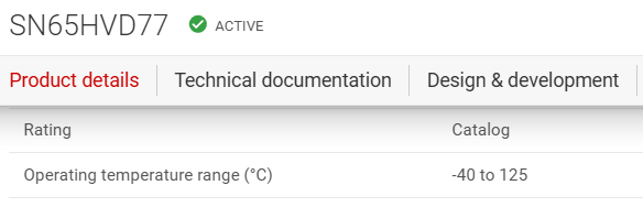

    I think there may be an error with TI's product filter for RS-485 & RS-422, as it lists SN65LBC179 as having an automotive rating:
    However, the SN65HVD77 is not, despite also having been characterized to 125C.
