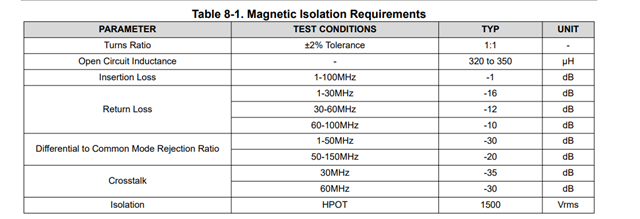

I have the choice of a few integrated magnetics RJ45's to use with this part, is it possible to get some feedback on which one is the most suitable please?
LPJK6064AONL
LPJK6069BHNL
LPJK6071A9NL
LPJK6072AHNL
LPJK6077AHNL
LPJK6077AHNL.pdfLPJK6072AHNL.pdfLPJK6071A9NL.pdfLPJK6069BHNL.pdfLPJK6064AONL.pdf
Is DP83867CR suitable to use within a PoE design, and do you have any specific design recommendations for using it?

  • Hi Graham,
    We have a PoE reference design: https://www.ti.com/tool/TIDA-010083
    Please refer to this design for design recommendations.
    In terms of magnetics recommendation, we recommend
    LPJK6072AHNL
    LPJK6077AHNL
    out of the five magnetics, but please note that we typically recommend -35dB for crosstalk but these have -30dB.

    Would you be able to explain why those are the most suitable please? Just so I understand for the future.
    I thought LPJK6069BHNL might be good due to hing more common mode chokes? Is there a reason why it is not?
    G
  • Hi Graham,
    On our datasheet, we recommend magnetics with separate center tap for each channel and with the following specification:
    Some of the magnetics had integrated center tap (all channels short to the same capacitors) and some did not meet the turns ratio. Lastly, some also did not meet the crosstalk specifications.
    We recommend magnetics like Pulse HX5008NL so please refer to that specification also.
