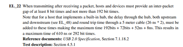

We conducted a USB 2.0 compliance test on a prototype board equipped with the TUSB8041A for one of our customers, and confirmed failures in the following two items:
  • EL_21 Sync Field Length Test
  • EL_22 Inter-packet Gap Between Host And Device Packet Test
We also performed a compliance test using the TUSB8041A evaluation board (TUSB8044RGCEVM) with a different model from our company, and observed failures in the same items.
However, when we conducted the compliance test directly on the port to which the evaluation board was connected, all items passed.

  • Kyohei:
         TUSB8041A is same die as TUSB8041, it did pass USBIF compliance test.
      Attached is document for the test.

    I understand EL_22. Do you have any comments regarding EL_21?
    Kyoehi
  • For EL-21, did customer use  32 bit SYNC field?
    Best
    Brian
  • Hi Brian,
    Thank you for your support.
    ■ Inquiry Cases:
    EL_21 and EL_22 are failing.
    ■ EL_21 Failure Details:
    Please refer to the table below. (Same results observed with the manufacturer's evaluation board.)
    ■ Our Interpretation Based on USB Specification Review:
    According to the USB Specification (Universal Serial Bus Specification Revision 2.0, April 27, 2000),
    the judgment criterion for EL_21 is 32 bits. However, when passing through a hub, a drop of up to 4 bits is allowed.
    Therefore, the acceptable range becomes 28 to 32 bits.
    Based on this, when converted to time (480 Mbps), the following range applies:
    58.3 ns ≦ Measured Value (62.8 ns) ≦ 67.7 ns
    ■ Excerpt from USB Specification:
    [Excerpt not provided in original text]
    7.1.10 Sync Pattern
    The SYNC pattern used for low-/full-speed transmission is required to be 3 KJ pairs followed by 2 K’s for a total
    of eight symbols. Figure 7-35 shows the NRZI bit pattern, which is prefixed to each low-/full-speed packet.
    The SYNC pattern used for high-speed transmission is required to be 15 KJ pairs followed by 2 K’s, for a total
    of 32 symbols. Hubs are allowed to drop up to 4 bits from the start of the SYNC pattern when repeating
    packets. Hubs must not corrupt any repeated bits of the SYNC field, however. Thus, after being repeated by
    5 hubs, a packet’s SYNC field may be as short as 12 bits.
    Kyohei

  • Hi Kyohie:
      customer's interpretation is correct, SYNC bits are dropped by hub.
    Best
