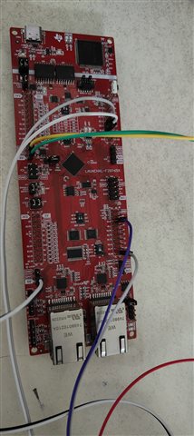

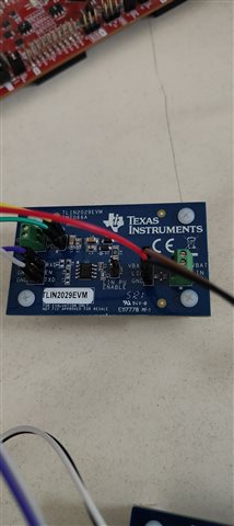

  • LAUNCHXL_P65X
    Above is LaunchXL_P65X connections
    Above is LIN_Responder
    Above is LIN_Commander
    Please find the hardware setup reference images.
    Best Regards
    Yash

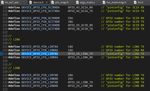

    According to the default GPIO Configurations I have made the connections. In the code provided by TI C2000Ware for external loopback ex_7 the GPIOs are as follows:
    LIN_TXA- IO-14
    LIN_RXA- IO15
    LIN_TXB- IO-24
    LIN_RXB- IO-25(From "device.h" file)
    GPIO_setPinConfig(DEVICE_GPIO_CFG_LINTXA);
    GPIO_setPinConfig(DEVICE_GPIO_CFG_LINRXA);
    GPIO_setPinConfig(DEVICE_GPIO_CFG_LINTXB);
    GPIO_setPinConfig(DEVICE_GPIO_CFG_LINRXB);

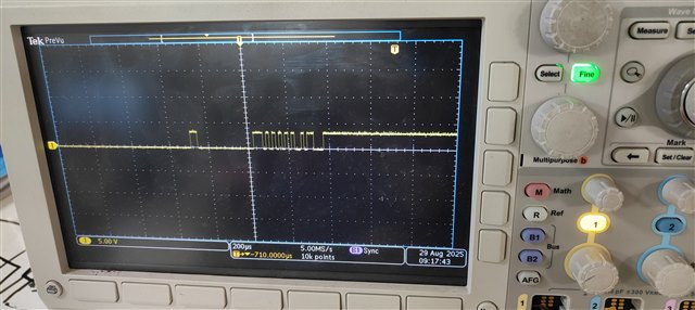

    After making proper connections, I checked the LIN signals on LINA_TX pin i.e. IO-14, the LIN signals are visible here on this IO.  Please refer to image attached.
    And while this connection is going toward the LIN Transceiver's TX pin same signal is visible, but not on the output of LIN Transceiver.
    Please suggest if I am missing any step.
    Yash

    Thanks for replying. The Baud used is 20Kbps and is matching for both TX device and RX device.
    The LIN_TX signal coming and visible(Signal on Oscilloscope) from the LaunchXL_F28P65X & is connected with the correct TX pin on TLIN2029 EVM(Please refer Images above). Required connections with the LIN_RX also.
    When checking the flow of code on debugging window, it stuck on " while(!LIN_isRxMatch(LINA_BASE));" API. This means the RX ID does not match, but I've confirmed with the RX_ID and TX_ID  both matches. And the parity is also enabled in the code.
    How should I look toward this issue.

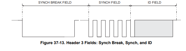

  • Hi Yash,
    It would then seem to be in the controller domain and not the transceiver. I.e., if you can see clean LIN_TX and LIN_RX waveforms (while ensuring that the LIN_RX pin of the MCU is really tied to the LIN_RX in the LINA_BASE driver), the transceiver is working as expected and would recommend seeking additional controller feedback from the controller support team (note that, most LIN receivers seem to allow only a 2% deviation from the 20 Kbps and if the MCU clock setup is off, the peripheral might discard valid frames) while referencing the below recommendations toward the issue:
    • A valid header wait time for LIN_isRxMatch I.e., sending a break field followed by the sync byte. It seems the ID may not be recognized if the break is too short or the sync byte is not 0x55.
      • Scope the break - count cycles and confirm ≥ 13 bit times.
      • Scope the sync - seems it should be 0x55, MSb first.
    • The ID may look wrong with a single bit error in your parity bits and would recommend double checking the code is calculating and inserting the two parity bits exactly as LIN specs require.
      • Scope the ID field - capture the 6-bit ID + parity bits that follow then run your own parity check on them.
      • You may add a receiver ID mode (filter = 0x3F) just to see if any match triggers. If it works, it would seem to be most likely a filter / ID mismatch issue.
    • Double check you have programmed your RX mailbox or ID filter exactly to match the same protected identifier you are transmitting I.e., the LIN peripheral seems to typically include an ID acceptance filter or mask.
      • If you never see RX match flag, try looping on the sync detection flag (LIN_isSyncDet(LINA_BASE)) - this will most likely indicate a header generation or clocking issue if it never fires, thanks.
    Michael.

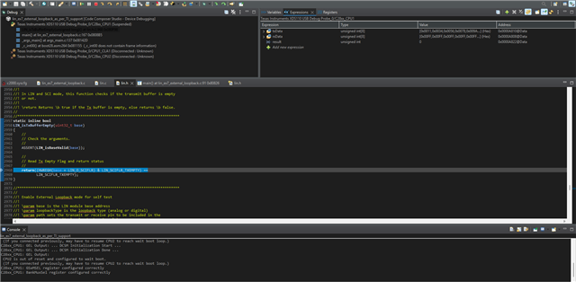

    While debugging the code, it was mostly stopping at only these two API's- "LIN_isTxBufferEmpty(LINA_BASE)" and "LIN_isRxMatch(LINB_BASE)".

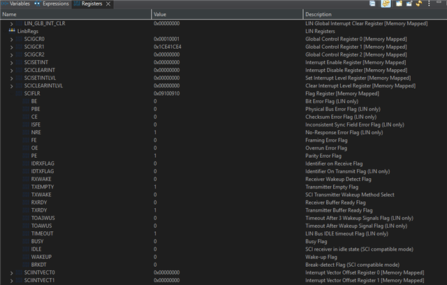

    A few things to check:

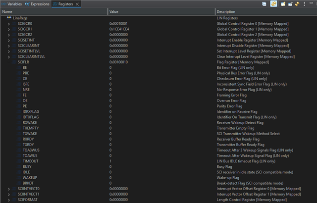

    • Which SYSCLK and VCLK frequencies do you have configured? And which baud rate are you using? There is sometimes error introduced by specific VCLK & baud rate combinations. Note that you can check the VCLK frequency by looking at the divider configured in the PERCLKDIVSEL.LINACLKDIV register field.
    • Can you check the SCIFLR register in the CCS register view (make sure Continuous Refresh is toggled on) and see if any error flags are going high when you are stuck at LIN_isRxMatch())?
    Delaney
  • Hi Delaney,
    The baud that i am using is the default baud provided by the TI's external loopback example-7(under API- LIN_initModule()). Below is the reference image for you.
    clk_image
    This is the SCIFLR values when checking in register view. Below is the reference image.
    sciflr_img
    The values which are getting high for "LINB" are-
    • NRE
    • PE
    • TXEMPTY
    • TXRDY
    • TIMEOUT
    The values which are getting low for "LINA" are only-
    • Timeout
    Please check the provided values of the registers.
    Yash

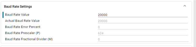

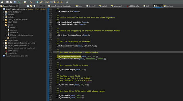

  • Hi Yash,

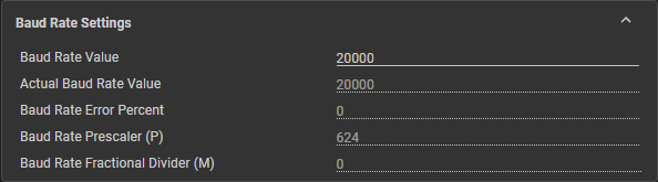

    The SYSCLK should be 200MHz and LINACLKDIV value is /2, so the VCLK frequency should be 100MHz. Based on this and a baud rate of 20kbps, there should be no significant error.
    Are you trying to achieve a baud rate of 20kbps? If so, based on the given clock settings, you should set the baud rate using the function parameters below in your code:
    LIN_setBaudRatePrescaler(LINA_BASE, 311U, 0U);
    Delaney
  • Hi Delaney,
    Yes I wanted to work with 20Kbps baud.
    As you said above i have set the parameters for LIN_setBaudRatePrescaler(LINA_BASE, 311U, 0U) that is present in "lin.c" file. Shown below-
    And set the Baud rate settings  in SysConfig file also. As per you suggested.
    But the successful completion of program is not proceeding. The program is getting stuck on function LIN_isTxBufferEmpty(), shown below-
    This is where mostly the program stucks. I am not getting why execution halts at this part of program.

    If you scope the TX line, do you see anything getting sent by the F28P65x? Is the TXEMPTY bit in the Register View low (with Continuous Refresh on)?
    Also note that there is no need to modify the Sysconfig file unless you are calling Board_init() in your program, which the LIN ex7 does not do. I was just showing it as an example for how to calculate the baud values. Calling the LIN_setBaudRatePrescaler() function in your main configurations should be sufficient.
    Delaney
  • Hi Delaney,
    Here is have checked the LIN-TX line on oscilloscope. It is getting high when I execute the program from debugger.
    I have mentioned the reference image for register with continuous refresh on.
    The value is low on TXEMPTY.
    Got the register values shown in earlier messages for your reference please.
    Yash
  • Hi Yash,
    The idle state of the TX line should be high (3.3V). Can you check if it ever goes low after reaching this high idle state? The TX line should show the following logic when it sends the header frame:
    If TXEMPTY is low, that means it still has data in the LIN TX buffer that it needs to transmit out (which the software writes).
    Delaney
  • Hi Delaney,
    I have checked the state of the LIN frame, it shows like this-
    What would be the approach now?
    Yash

  • Hi Yash,
    Can you try adding the function call for LIN_enableExtLoopback() after the LIN_initModule() line? It seems this is missing from the ex7 in C2000ware but it should be necessary to do a loopback between LINA and LINB on the same device.
    Delaney
  • Hi Delaney,
    I have added & checked LIN_enableExtLoopBack(), with both Digital & Analog Loopback parameters separate for both TX and RX.
    But while debugging the code it gets stuck in this loop- "while(!LIN_isRxMatch(LINB_BASE))".
    And the result variable shows '0'. No changes observed here.

  • Hi Yash,
    Can you take a look at this thread and make sure your implementation matches: (+) LAUNCHXL-F280039C: lin_ex7_external_loopback - C2000 microcontrollers forum - C2000Tm︎ microcontrollers - TI E2E support forums? This is why I suggested adding the LIN_enableExtLoopback() line.
    Delaney
  • Hi Delaney,
    I referred the forum you mentioned and one another forum(Forum LINK ) too regarding this same issue. It resolved the problem.
    Now the external communication is successfully working.
    Yash
