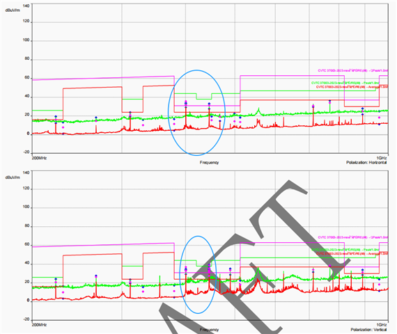

The head unit and the screen communication via FPD-LINK. The serializer is DS90UB941, and the deserializer is DS90UB948.

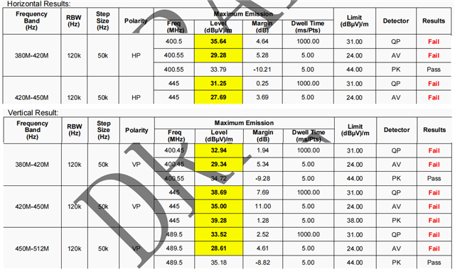

In the EMC RE test, the following frequency points exceeded the limit value.
400 MHz, 450 MHz, and 845 MHz.
Spectrum analyzer on the head unit, the exceeded noise from the FPD-LINK between DS90UB941 and DS90UB947.
Question: Is it possible to adjust the FPD-LINK drive strength through software? If so, which registers control this setting?
Thank you !

    1. below table is the RE data

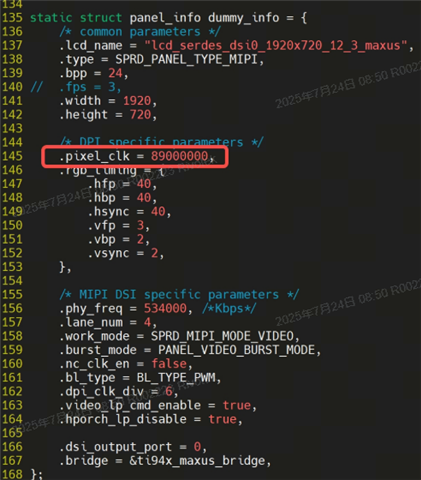

    2. The PCLK of screnn is 89MHz

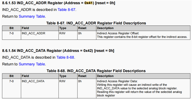

    (1) One is about your suggestion of register. I study the register of spec of DS90UB941. These registers don't seem to be related to VOD level?
    (2) Regarding the noise point at 445MHz, it is 5 times the PCLK frequency. Could PCLK be the noise source of the 445MHz noise point?
    Based on this data, the two failing frequencies are 400MHz and 445MHz. The 445MHz spike could be resonance of the PCLK at 5 times the nyquist as you mentioned. The 400MHz would not fall as a harmonic of the PCLK, which is interesting.
    By the way, when the DS90UB941 is turned off, the 445MHz and 400MHz noise points disappear.
    This is a good test to verify source of emissions. Was the deserializer turned off as well?
    We need to pinpoint if RE is Serializer or Deserializer related and whether it is PCLK dependent.
    The register to control VOD is on an indirect register page and the register is not made public on our datasheets. Register 0x41-0x42 control access to these indirect registers. Please follow the recipe provided earlier and verify the output change on oscilloscope.
