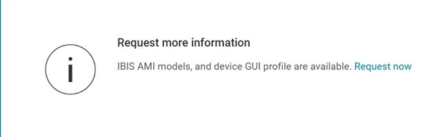

I'd like to get DS280BR810 Programming Guide.
I requested it on product page, but this status is pending.
After TI accepts it, is it possible to get this document?

    2. Yes, once you are approved you will have access to the device's programming guide. I can check internally to see why approval is still pending.
