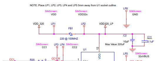

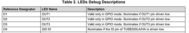

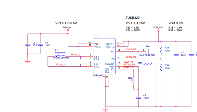

    The customer confirmed operation using the TUSB320LAIEVM and has questions.
    Could you please advise?
    We confirmed operation using the TUSB320LAIEVM.
    Operation was confirmed after changing the VDD from 5.5V to 3.3V.
    Dip Switch setting
    SW1.1 ON
    SW1.2 OFF
    SW1.3 OFF
    SW1.4 OFF
    SW1.5 OFF
    SW1.6 ON
    SW1.7 ON
    SW1.8 OFF
    I2C communication was not used.
    In this condition, two mobile battery (5V3A) and smart phone for PD were connected and operation was confirmed.
    Although it varied depending on the battery type, 2.4A/1.9A was supplied. (We believe the current output was not possible due to the drop in battery voltage.)
    The CC1, CC2, voltages and current  for each device are as follows:
    CC1 CC2 Voltage Current
    Mobile Battery1 0.175V 0.603V 4.546V 2.483A

    D1, D2 and D3 is OFF. D4 is ON.

    D4 indicates the ID pin is low though, so the device is set as a DFP.

    The EVM has been modified to connect to our battery board. An MCU is mounted on the battery board.
    VBUS (5V) is connected to TP5 via our USB output (5V).
    *Pattern cut between "PWR_IN" and "VIN-1 and VIN-2 of U3."
    *Jumper J8 is removed.
    *LP2 and VDD_320 are supplied with 5V from an external power supply.
    *TUSB320's EN is low, and ADDR is 5V (high input).
    *R11/R13 (I2C) are removed. J1-1 and J-3 are connected to the I2C terminals on the battery board, and 3.3V is internally pulled up with a 4.7kΩ resistor.
