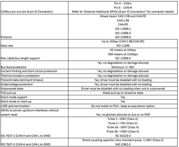

Does TCAN4551-Q1 has ISO 7367-2/ISO 16750-2 compliance?
The customer is looking for CAN BUS controller with ISO 7367-2/ISO 16750-2 compliance

The TCAN4551-Q1 is not tested for compliance to either the ISO 7367-2 or ISO 16750-2 specifications, and doesn't claim compliance to those in the datasheet. I do not know if it would pass the requirements of either of those standards and the customer would need to run the certification tests themselves.

Thanks for your reply, so do we have can bus controller that has claimed these two compliance?

The TCAN455x family of devices are the only CAN FD controllers that are not embedded in a MCU that I am aware of. Therefore I would say that we don't have any stand alone CAN FD Controllers that claim compliance to the ISO 7367-2 or ISO 16750-2 specifications.
