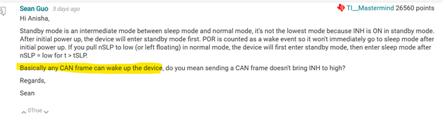

    Standby mode is an intermediate mode between sleep mode and normal mode, it's not the lowest mode because INH is ON in standby mode. After initial power up, the device will enter standby mode first. POR is counted as a wake event so it won't immediately go to sleep mode after initial power up. If you pull nSLP to low (or left floating) in normal mode, the device will first enter standby mode, then enter sleep mode after nSLP = low for t > tSLP.
    Basically any CAN frame can wake up the device, do you mean sending a CAN frame doesn't bring INH to high?

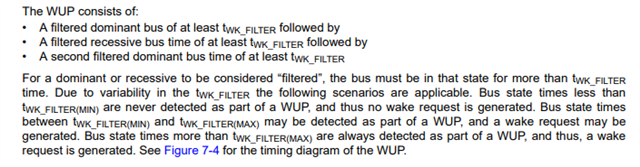

  • This is an excerpt from Data Sheet - What is the wakeup pattern referred here
  • Hi Anisha,
    A valid WUP is a dominant + recessive + dominant pattern, each bit time should be at least tWK_FILTER. Please find a more detailed description in 7.4.1.3.1
    Can you check if the duration of each state meet this requirement?

  • Is the highlighted statement true? Does the chip wakeup with any CAN message and make the INH high?  Currently we don't have facility to check the timing duration of CAN Message. Is it possible to share an example of a sleep wakeup feature?
  • Hi Anisha,
    Sean is currently OoO at the moment. Any valid WUP wakes the device similar to the mentioned 7.4.1.3.1 of the data sheet. This ensures unintentional wake ups do not occur, thanks.

    Here is an example of a CAN frame acting as a WUP for a CAN transceiver. The wake filter for a WUP is defined to be a maximum of 1.8us for this device. With a data rate of 500kbps, the bit time of 2us satisfies this requirement for the filter. Because a CAN frame is guaranteed to have at least one set of transitions that include a dominant-recessive-dominant pattern this means any CAN frame at this data rate will include a WUP.

  • Hi Anisha,
    A waveform generator should not be needed to evaluate here. Any CAN message ID at 500kbps will act as a WUP and wake the device. The example above is a CAN frame at 500kbps. The ID and data can be seen in the terminal on the right side of the first screenshot.
