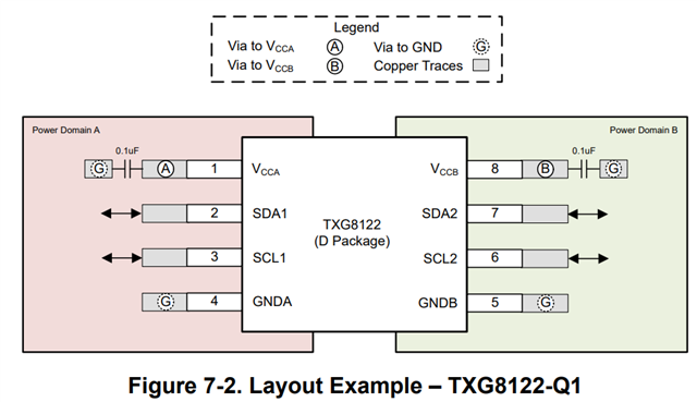

  • Hello Yu,
    I would follow the layout example on how to configure two devices with different ground offsets.
    Josh
