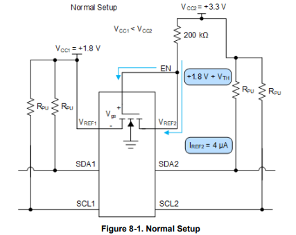

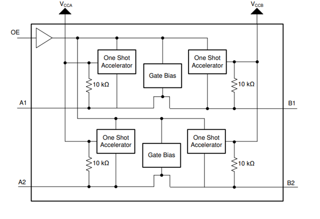

    For sure. They are similar level translators in that they are both passive devices and do not buffer I2C/I3C signals. They differ in that TXS has internal 10k PU resistors on both sides of the device as well as rise-time accelerators on both the input and output for faster rising edges.
    TCA39306 is purely passive and requires external pullups on the both sides of the device for it to work. See the internal structures from the block diagrams below:
    TCA39306:
    Not shown in TCA39306, there are passFET's connecting SDA1 to SDA2 and SCL1 to SCL2.
    TXS0102:

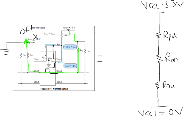

    According to the datasheet, when the OE pin is Low and either VCCA or VCCB power supply is turned off, all outputs become high-impedance.
    In that case, what happens to the input/output pins when the OE pin is High and either VCCA or VCCB power supply is turned off?
    Keita
  • Hi Keita,
    In the case you described, OE = HIGH, VCCA or VCCB = OFF, then you will get a voltage divider.
    Please let me know if this makes sense.
    The opposite is true if VCCA = ON and VCCB = OFF. Then the current will flow from VCCA into the VCCB powered off supply while OE=HIGH.
