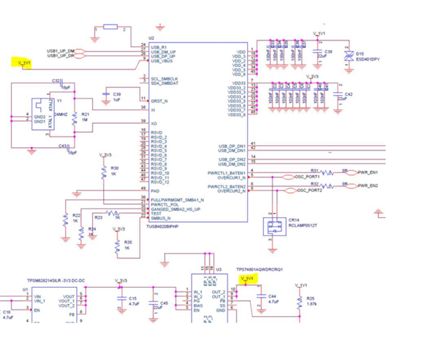

If an USB_ VBUS is directly connected to a 1.1V power supply without voltage division or current limiting protection, would it cause the IC to burn out?"

USB_VBUS is between 450mv to 1V, 1.1v pretty marginal, but I don't think it will damage the device.
Best
Brian

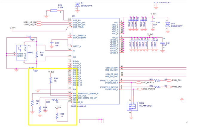

Please help evaluate whether there are any issues with the current circuit design in the yellow box. Thank you.
