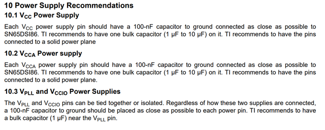

    2. Please follow the "10 Power Supply Recommendations" for power supply decoupling capacitors. For the VCCA pin, please place 100 nF capacitors for each pin, close to the pin.

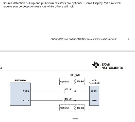

    => I used 10nF and 100nF by referring to EVM's circuit. Should I change 10nF to 100nF?
    3. The AUXP and AUXN pins should have pulldown and pullup resistors of 100 kOhms populated.
    ==> I checked the following in the guide document and it is currently only optionally processed. Is it a mandatory specification?

    2. Using 10 nF and 100 nF capacitors here will also be okay.
    3. Please refer to whether the display/panel eDP/DP AUX requires the pullup/pulldown resistors, since some DP sinks require the AUX pullup/pulldown resistors and others may not.
