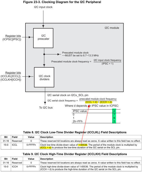

I2C has two modes: standard 100KHz and fast 400KHz. However, I believe I2C speed slower than standard mode can also be achieved since TI processor's I2C module has register bits ICCLKH[ICCH], ICCLKL[ICCL] which could be used to divide down I2C prescaler clock (which is required to be between [6.7, 13.3] MHz). Since the range of both is [0, 65536], considering maximum ICCLKH[ICCH] + ICCLKL[ICCL] = 217 = 128K, and assuming d=0 (see green highlight), then the lowest achievable I2Cx_SCL pin clock would be 7MHz (7-12MHz range) prescaler clock divides 217 = 7 × 220 / 217 = 7 × 23 = 56Hz, which is an extremely low speed for a digital communication.

1.    Is this 56Hz clock actually attainable?
2.    When clock speed goes down, wavelength would increase so that more and more the separation between tracks no longer causes problem. But how slow does the clock need to be for SCL and SDA to be free from interference/crosstalk, when separation = width(SCL) = width(SDA) = 4mil?
3.    Is 4mil separation too small for I2C communication?
