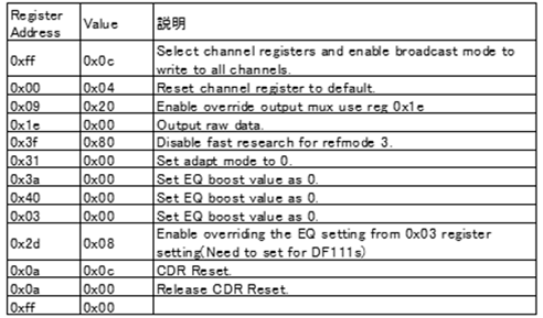

Q4: About setting parameters on the DS110DF410SQy, he plans to set the registers in order from top to bottom, as shown below. Is this orders are OK or any problems?
