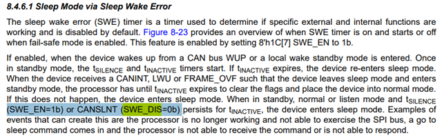

My customer wants to change from TCAN1145 to TCAN1465, we need to know the register difference from software perspective.
Besides, what's the difference for SWE_EN=1 and SWE_DIS=0, is it a typo, it should be CANSLNT_SWE_DIS=0?
