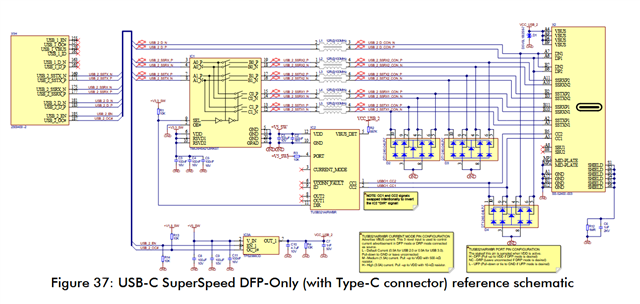

I'm currently working on a design with the TUSB321AI, USB 3.0 Mux and an USB C Host Port.
However the TUSB321AI never changes the value of the DIR Pin to switch the Mux around. I confirmed that both CC Pins have a proper voltage as expected.
If I swap the plug polarity around, the voltages on the CC Pins also swap around accordingly.
Could somebody review my schematic if I made a mistake?
MarcelUSB_C_Mux_H1.pdf
  • Hi Marcel,
    Are you using the ID pin to control VBUS? I don't see anywhere the ID pin may be routed to on this schematic. If not, then the CC negotiation process may not be successful, causing the DIR pin to not change and the port to only work in one orientation.
    The ID pin should be used to control VBUS when the ID pin is low via a power switch or GPIO of the SOC. Please confirm this is being utilized properly.
    Ryan
  • No, we based our Design on the example from our SoM Manufacturer:
    In this example the ID Pin isn't used aswell.
    However if I remove the VBUS_DET resistor the TUSB321AI switches the DIR Pin accordingly.
  • Hi Marcel,
    If the ID pin, then how is VBUS being supplied? Is it being controlled elsewhere, or supplied at all times?
    VBUS_DET should not be needed for a DFP application, so removing that is okay.
    Does the DIR pin work for both cable flip orientations? We typically expect it to only work on one side if VBUS is not being controlled.
    Ryan
  • VBUS is being supplied through an USB Power Switch which is controlled by the USB Host.
    Yes both directions work.
  • Hi Marcel,
    If both directions work, then it seems like the TUSB321AI is working as expected.
    I would still recommend using the ID pin to control VBUS, just to ensure that this does not potentially become an issue down the line.
    Ryan
