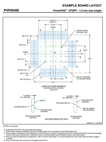

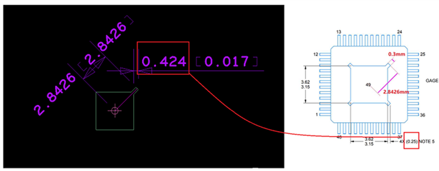

Please help to check TUSB8020B-Q1 dimension as indicated in the figure below, thanks.

I'm looking for this information, but it is proving difficult to find. Why do need this measurement?
For a sample solder mask please refer to the following details in the DS.
it's necessary to depict the actual physical dimensions of the component in the Package Assembly layer.
This is one of our footprint design rules.
Hi Vishesh,
We drafted the design based on the 2.8426mm dimension, but it does not match the actual measurement.
Could you please double-check this? Thanks.
I will look in the background, as this isn't a value we typically have defined, and let you know what I find.
Ryan
Please go to this link: https://vendor.ultralibrarian.com/TI/embedded/?gpn=TUSB8020B&package=PHP&pin=48&sid=018181b71301005ea47cee035c080506f0038067007e8&c=1
From here, you should be able to download the device dimensions to get a proper layout of the device dimensions.
