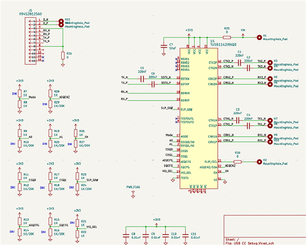

Hello, I have the following schematic made; all my 3.1 connections are coming from wires soldered from another board. These wires are really short and are USB 90-Ohm wires. The layout of the board was taken into consideration from the datasheet, there is at least 0.4 inches of space from the series caps from the chip, and they are direct. The connector J1 uses a custom cable I made that I know is reliable because I've tested with it before. Pin 21 (Flip) comes from a GPIO pin on the other board which also matches the logic with the TUSB1142 (GPIO = 1 = CC2 is selected, GPIO = 0 = CC1 is selected). +3V3 is also supplied from the board as well.
My current method of testing is plugging in J1 into my PC, and plugging in a flash drive into the USB-C receptacle that the wires come from. From my observations on the oscilloscope, it seems that data may be passing through the chip however my PC is still not able to see the flash drive. I've tried adjusting the gain from low to high, then somewhere in between, I've tried turning on/off AEQ, I've tried removing the series capacitors, I've pulled SLP-S0# high, low, and even floating and I'm still not able to find the issue as to why data is not passing through properly.
I don't believe it is a hardware issue, I've done sketchier things with longer wires that aren't meant for signals and was able to get it to work. I believe there's a configuration I'm not doing right, I've looked through the datasheet a good handful of times, re-read the pin descriptions but can't find what could be causing the issue.
My end goal is simply to pass USB3.1 data using this chip. I'd appreciate if I can get any clarification if I'm doing something wrong.
Please let me know if there's anything that I need to clear up.
  • I am suspecting the series caps missing on the SSRX lines, I don't think I can cleanly jam these in but I have ordered a new board that does have these.

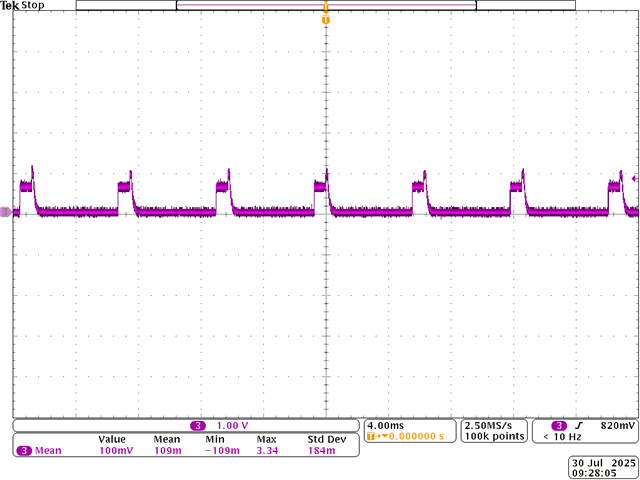

  • Hello Vishesh,
    I don't know where the 1V offset comes from.
    Here is a waveform I managed to capture on TX2+ of the USB-C receptacle, this should be H3 on the schematic I shared.

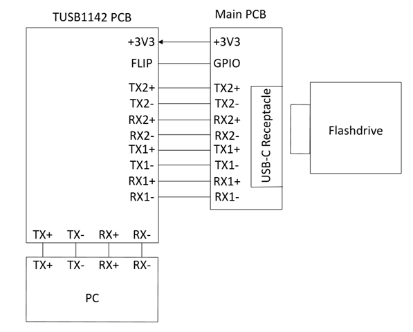

    Can you share a system block diagram of the test?
    What's the sampling rate of the scope/ is the probe used rated for high speed signals?
    Please see the attached block diagram and let me know if anything's uncertain. The GPIO pin has a 10K pull-up to +3V3. All data connections on the Main PCB come from the USB-C receptacle which then go out through wires onto the PCB with the TUSB1142 on it. TX+/- and RX+/- Pairs at the bottom of the TUSB1142 PCB is the J1 connector.
    The sampling rate should be 5.00 GS/s with 100k record points.

  • From what I see in the schematic snippet provided, I dont see anything that would cause this.
    Are you able to send the full PDF file, so I can double confirm?
  • USB Panel CC Adapter Board.pdf
    Hello Vishesh,
    Attached is the full PDF file of the schematic. I forgot to mention that the caps I used are only 100nF as opposed to 200nF though I don't believe this might cause any issues.

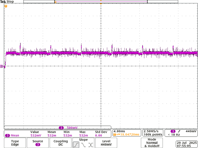

  • I've been probing around some more and when I have the flash drive plugged in and nothing on the J1 connector, I see the following waveform on the RX+ pin. If I'm not mistaken, this should be the either the flash drive or thee TUSB1142 attempting enumeration. TX pins also don't have any activity.
  • This looks somewhat like an FLPS pattern, but I am not sure. Can you test on the EVM to confirm if this is a system issue or board issue?
    There are too many unknowns, which makes this difficult to narrow down. Id like to see the waveforms with a known working board.

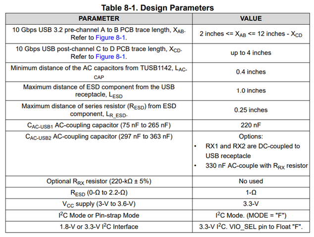

    Before I place the order, can you clarify the distance measuring in the datasheet? Forexample, "minimum distance of the AC capacitors from TUSB1142" is this measurement from the center of the pads of the TUSB1142 to the center of the pads of the capacitors, or is it from the center of both components?
    This measurement is from the center of the pads of the TUSB1142 to the center of the pads of the capacitors.
