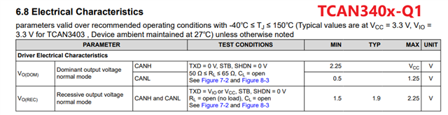

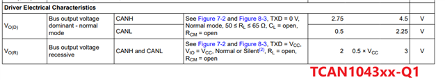

Can TCAN340x-Q1 CAN BUS be connect to 5V CAN BUS such as TCAN1043? Seems 1.9V CANL don't meet the TCAN1043 CAHL requirement.

Hi Xiaowei,
Yes, TCAN340x can communicate with TCAN1043. Please refer to this post for details: (+) 3.3V and 5V CAN Bus Transceivers - Interface forum - Interface - TI E2E support forums
