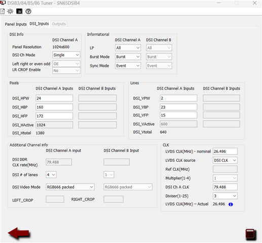

    My customer use SN65DSI84 for Single-Link LVDS,4 lane to driver LCD(1024x600),the attachment is LCD datasheet.Could you pls help offer a Register Configuration Table for this case? Thanks.

  • Ikram,
       The customer has already used this tool to generate register configurations, but the PLL cannot be locked. Unable to lock in Test Pattern mode. Could you pls help review this register configurations? Thanks.

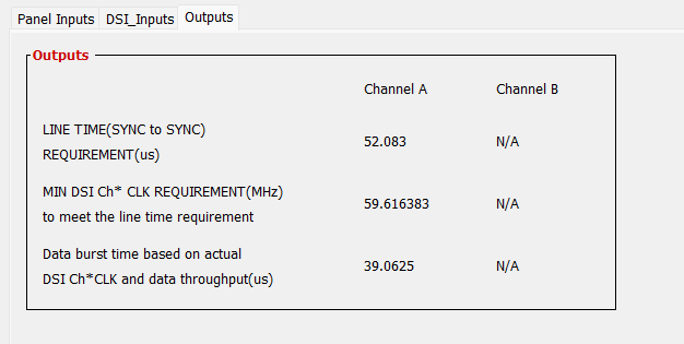

  • Hi Jon,
    You can use the DSI Tuner tool to enter the resolutions that are within the specifications of the display as you shared, and which the SoC or DSI source will generate. Here are the settings I used:
    Here is the Test pattern CSR register list it generated:

    The PLL_EN bit and SOFT_RESET bit are not set as they need to be set per the recommended sequence defined in the datasheet
    Please try using the test pattern, or generate similar register list to configure based on preferred timings.
