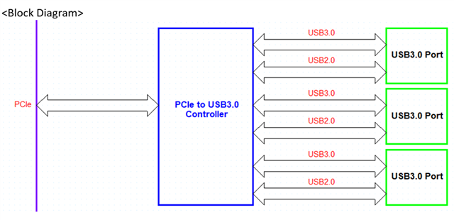

Hi Team,
My customer need a PCIE to USB solution, our TUSB7320 / 7340 should able to support.
But they need Windows 11 driver support, do we plan to provide this driver ?
Kai

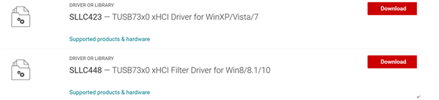

Hi Brian,
May I know what is the difference between xHCI driver and the driver on our TI.com page?
Both can implement what customer need?
Kai
xHCI is the driver for all USB host bridge device from PCIe to USB3, it should works for USB3 devices include TUSB7340.
TI driver on TI.com is only works for TUSB7340.
Best
brian
