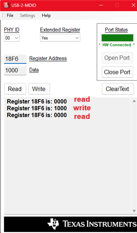

  • Hi Michal,
    You mentioned the adin1100 - to confirm, are the registers for the DP83TD510E?
    If yes, it looks like bit 12 of register 0x18F6 is set to 0. This indicates the PAM3 amplitude is set to 1.0 Vpp. To increase transmit and receive capability, this amplitude can be set to 2.4 Vpp by setting bit 12 of this register to 1. Please let me know if this helps establish a link at longer cable lengths.
    Greg
  • Hi Greg,
    That is correct, these are DP83TD510E registers. Apologize for the mixup.
    I tried setting these registers up with no success. It seems like it just ignores it. After a write operation I observe no changes.
    Apart from the 1000m cable, I have also tried doing that on shorter cable that works. And I observe no changes as well. The 0x18F6 register is still 0x0000.
  • Hi Michal,
    This could potentially occur due to 0x18F6 being an extended register. It should be written to using the steps detailed in section 6.3.10 of the device data sheet. The register read access is detailed in this table as well:
    Please let me know if this works. If you are still not able to access 0x18F6, are you able to access other extended registers?
    Greg

  • Writing operation works for both extended and non-extended registers, I checked it by writing some values to some other registers.
    With provided steps, I've confirmed that each step
    Register             Write
    0x000D              0x0001
    0x000E              0x08F6
    0x000D              0x4001
    was in fact written to. After each write operation I have also read it and confirmed that it was intended value.
    These steps has not solved the issue. There is still no link. Both registers 0x18F6 and 0x08F6 reads 0x0000.

  • Hi Michal,
    Please try the following script to write to 0x18F6 to enable 2.4 Vpp operating mode:
    Ensure that "Extended Register" is set to "No."
    Write
    Register             Write
    0x000D              0x0001
    0x000E              0x08F6
    0x000D              0x4001
    0x000E              0x1000              - sets bit 12 of the register to 1
    Read
    Register             Write
    0x000D              0x0001
    0x000E              0x08F6
    0x000D              0x4001
    Read 0x000E
    The value in 0x000E should then be 0x1000. Please let me know if this allows your device to enable 2.4 Vpp operating mode and link with longer cables.
